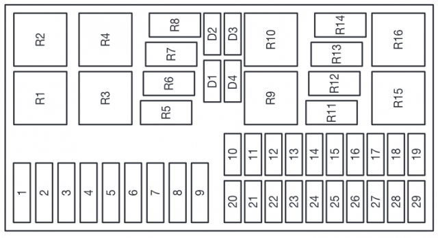

I bought this nice 07 Focus se and I am not getting cool air because the condenser fan doesn't kick on. I wanted to check fuses, and by far this is one of the car that I haven't seen a names on the fuse boxes. I don't know which fuse or relay is for the condenser fan . Any insight would be appreciated....

.Fuse 21 is continues... I just edited that my ac isn't cold, and the clutch of the compressor engages for a couple sec and disengages and so on.
