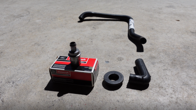

Here is a pic of all the parts that make up the PCV system:
