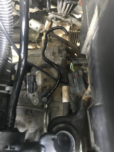

I found a loose tubing hanging in the car. See the attached photo. I plug it where I thought it would go. It is snapped down to something on one end but not connected at the other end. Does anyone know if it should be connected to something?

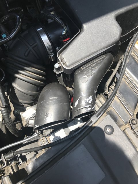

Please see the attached photos of the Air Tube in the front of the car. And the tubing I found just hanging in the engine compartment.

Is it possible for someone to give me a picture of their 2015 Ford Focus engine area so I know what should be attached to one end of the tubing. Please see the pictures attached.

The "air tube" is the one that is on the transmission / differential housing - that is an air-breather - the 1 photo that is the "snorkel" that is where the air inlet is - it's a little restriction to allow that MAF sensor on the main intake snorkel hose from the air box (filter) to the throttle body - take in the air in the "chamber" at a given rate that the PCM is calibrated to "see".
To know how this works is to look up Plenum - the tuning that they did to make the air box and the piping a given size and flow rate - shows how much the intake plume and the chamber design adds to the motors' miracle that it even runs. And even provide the power it does in torque at low RPM (1K to 2K RPM range)
So that Air breather hose should have a second piece that routes to the airbox - this keeps water and debris from getting sucked into the shifter solenoid and controller that is housed in the bell housing - that harness right next to it is the tell-tale for the reason.

The hose? Doesn't go to the airbox, it rises up to be held in a clippy from a hose it clips with that goes to the Brake booster

I was just thinking it had to do something with brakes. Since there was fluid on the tube. I will stop by the auto parts store tomorrow or go to the dealership if they don’t have it.
