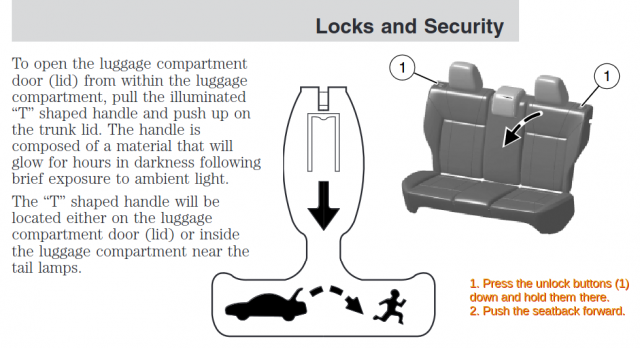

IF you have the sedan, 4-door - you'll have to open and unfold the rear passenger seats and check the condition of the rear hatch internal release - if it's been damaged or not properly seated, this can prevent the relay and switch from operating and unlatching the catch - because the catch is stuck due to that emergency pull handle is not letting the catch properly seat itself.
In the Hatchback, the process doesn't have an emergency pull handle - but it is a good idea to see if placing your hand on the rear panel and pushing down while operating either the button or the keyfob - and seeing if releasing some tension on the catch can help make the system move that latch so you can open it - this pressing down effort might help.

That's why I asked about that rear hood latch "handle" - if it's ok, yet the button does not work, then suspect the wiring to the rear trunk lid.
