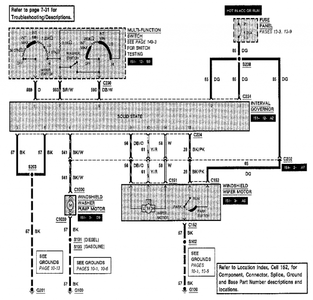

Ok, to go a little further into this, the Wiper Motor - should have a switch contact that when the wipers are originally parked, engage - but when you apply power, the wiper motor "wakes up" pulls itself from the switch that engages a set of contacts, to disengage that switch - this is thru a separate wire in the harness going to it - it's live when the wipers are on, to tell the motor to move from park. Once the wipers are operational - the BCM (Body Control Module) handles all the fun.

Otherwise, the Wiper motor is suspect has having a bad wire or switch to "park" itself - it may not fully engage (transfer to another) a set of contacts to tell the system it is fully parked - it uses these contacts to allow the Motor to receive a wakeup call and move. IF the wire is open, the motor doesn't receive enough energy to park (run thru and seat the wipers) in which the switch - once it engages, tells the RELAY for the wipers, I'm parked - thanks you can turn off now - which then the Relay powers down and it's done until next time. Instead, it parks itself...at it's default position which would be in-between the set of contacts - the wiper power duration the BCM is to supply - has run out - so has it's power to move - so stops dead in it's tracks...

Below, is not a true representation of your Wiper Motor, but used in the description above to help you understand the Motor wiring and the switch, also how the motor itself has a series of contacts - one of them REVERSES the motor to force the gearing to "Park" the arms - and also reset the motor to allow it to start in the correct direction when they are turned back on.
