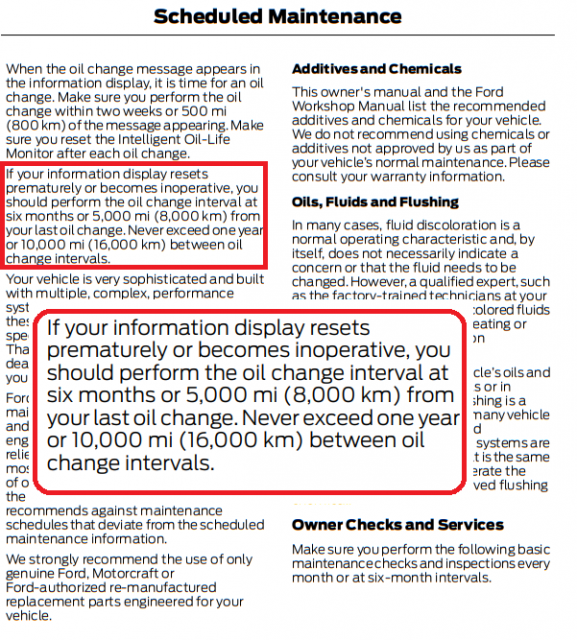

Hi all. First post here. Looking for a little opinion-help as well as link to "official" group I've got a 2017 Focus, model name/# unknown. No flag, badge, or other indicator that I can find. Does anyone know how to ID the model if there's no badge? I've been trying to find the tie and/or mileage between oil changes, as defined by Ford. I realize that those are not purely exact numbers, but a ball park that often in reality changes with usage. This car has what I'd call low to moderate service ... it's driven daily, mostly between 40 MPH and 65 MPH depending on which road we're on and anything over 20 miles/day feels very excessive. I don't know if that's considered low usage or moderate usage. The current mileage is 22586, and the last receipt I have for a change is dated 1/13/22 with mileage reading 20676 so that's not quite 2000 miles. Both of those seem very low to me, and I can't seem to find any actual recommendations in the manual ... maybe it varies by model # but I'm not sure. I know the technology has bypassed the old 3K / 3 month recommendations. So ... any ideas what Ford really recommends for this model, and any links to where I can find that? Thanks in advance for any assistance given!

Here's another hint, in your owners manual - page 411 (neat!)

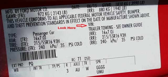

As far as ID'ing the "model" look for a sticker on the Drivers side door - to the front - on the chassis itself in the well of the door jamb.
Kinda' like this...
Or you'll have to locate the REGISTRATION for the vehicle and use that for your research.
