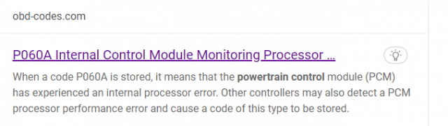

Lots of times the PCM code - being this P060A -
Could mean many things, but all related back to self-test diagnostics in the processor module - and too many times one or others have failed this self-test (Power On Self-Test is a good example) but that could be from intermittent power supply glitches caused by corroded wiring or bad connections - not directly related to the sensor in question - but the sensor is sensitive enough to changes in the voltage power supply to it - to set a code along with the PCM one as a means to "start here"
