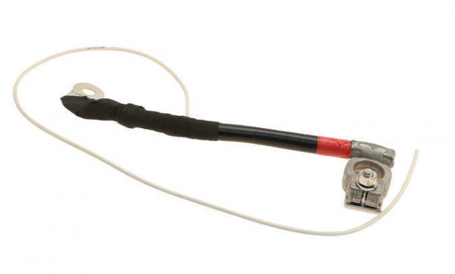

The above? Is your POSITIVE battery post jumper that feeds into the main "buss" to the fuseblock

While you're at it, remove the battery and even the Airbox (Air Filter assembly) and expose the Body and Frame grounding points.
Might want to clean them up see if it can recover. - would not hurt to review the vid this comes from...
Ford Focus $5 Transmission fix | GRAMPZQUAD - YouTube
Why does this become a concern, age and oxides. IF you see rust, it's already working on degrading the performance of your vehicle electrically, which then changes the level of power presence for the battery to supply power it once had to the system.

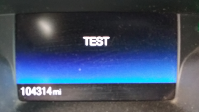

Ever go into the HEC "TEST" mode?
Locate your LEFT SIDE "OK" and menu scrolling keys...
Insert your Key into the IGNITION...PRESS and HOLD OK - then turn it (Your Key) to ON (Run - not Start - yet)
Keep holding OK as it "boots"
Soon you'll see this...
in your front panel Display Box (your HEC)​
Release the OK button, use the Up and Down Scroll buttons on that LEFT side to find various pages of information you may find useful - including this one...
