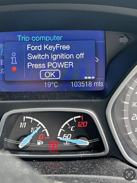

My first post on here and Im hoping someone can help with a problem I'm having with my keyless start focus not starting. When you press the start button the car isn't cranking up and i'm getting the following error message Ford KeyFree Switch Ignition Off Press Power error message.

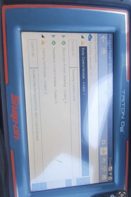

The first thing i did was replace the battery on both the key fobs and this didn't make any difference. I then got a mechanic to plug his diagnostic machine in and he got the following error code under Body Control Module: B1026-87 Sterling Column Lock. He then recommended a local guy who specialises in ECU and coding etc to look at it.
