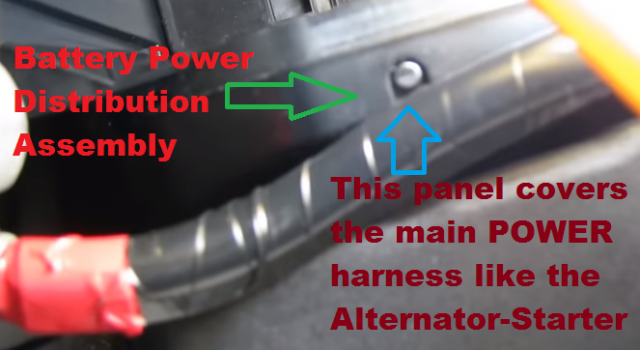

The "battery light" usually means that the Charging system has a problem, as to what though? Might need to investigate more into the battery and ground cable, and see where the positive cable goes into that "black box" just in front of the battery?
But that requires all that stuff you took off just to put the battery in, back off, and pull the battery out, so you can see where the distribution box assembly and it's conditions is in?

The panel is where the main Positive cable goes into.
But the Alternator and Starter - let alone other sub-systems
are getting their power from this panel.
The Blue arrow shows where one of the lift tabs are at.
Once the battery is out, this panel can be inspected more closely.​
