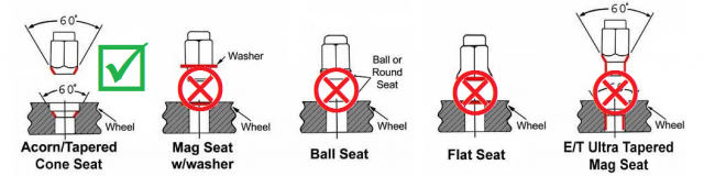

hi I'm chaz and have a 2018 focus se. these cars are a pain. looking to replace my lug nuts without caps. which seating do I need? seem to have 3 different lug seatings.
1,889
1,349
Most of the Focus line use M12 X 1.50mm (Pitch) thread size, usually fits a 19MM socket.

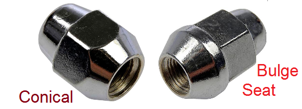

But the seat configuration you're looking for is called "Bulge Seat" style. Also known as Conical.
To use the word "Bulge Seat" is for the use in USED wheels - and new.
When a wheel is driven on, then removed and its tire replaced then placed back on - some wear at the seat occurs during the lifetime of that tire that was used on it. The seat - it can deform enough to make the wheel wobble - so the "Bulge" seat types are slightly oversized to handle the seating and proper torque needed to keep the wheel to the hub and you on the road.
To Help: Notice the "Bulge Seat" style
is slightly oversized compared to a typical Conical style
Either way:
They can also be called Acorn - because they look like what Squirrels go after in the Fall.
So conical and Bulge Conical and Bulge Seat - are adequate - but when replacing these Wheel nuts, remember that if you put them on, you become responsible for their proper torquing and use.
