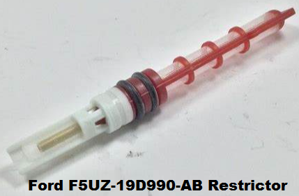

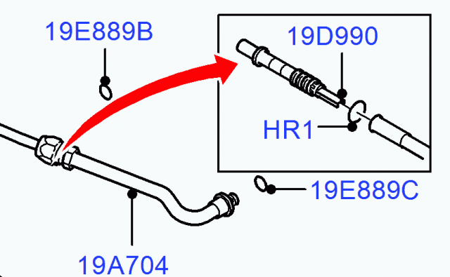

Another is the needle valve that causes the constriction, and the expansion of the freon thru that nozzle...
Your valve Reference may vary, but this gives you the idea.
